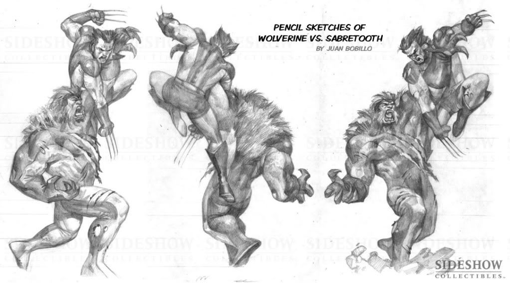

The stage was then set to select a pose for both characters. Martin began thinking of a pose that properly reflected all the strengths of the two characters. Professional penciler, Juan Bobillo interprets these ideas by first turning them into an illustration, and then produces what they call "turn-arounds". Once approved by the licensor, Martin began the sculpting phase.

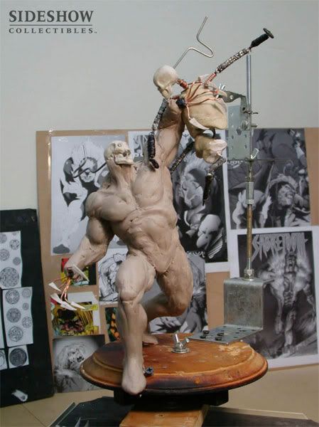

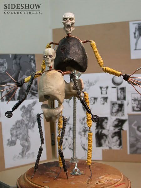

With the approved concept completed, the next step is to establish the relationship size and proper physical anatomy between both contenders.
Martin assembled a wire skeleton mixed with Aves epoxy clay for the anatomy then a thick layer of Super Sculpey is added to gain muscular volume. Once the body forms have been properly established, Martin properly positions the figure the way it has been illustrated.
Once the pose and body shape has been finalized, and muscles have been defined, Martin bakes the sculpture to solidify it.

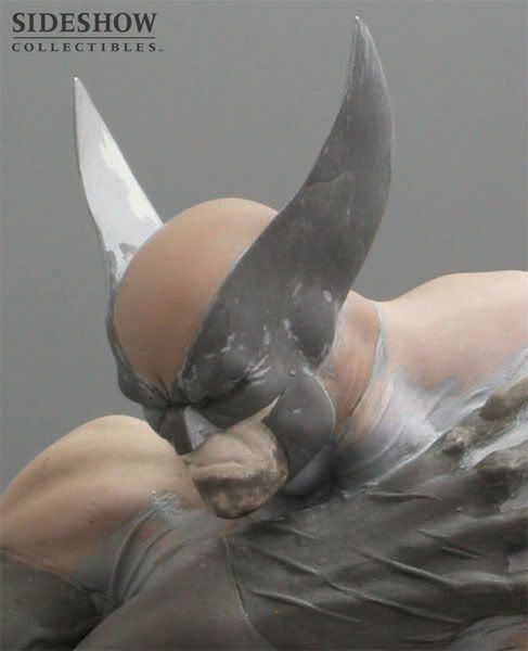

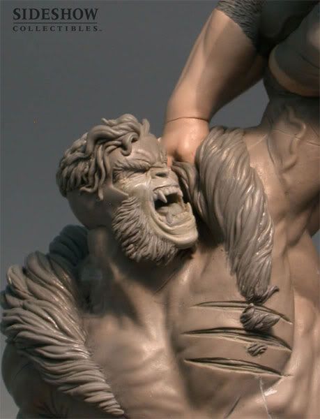

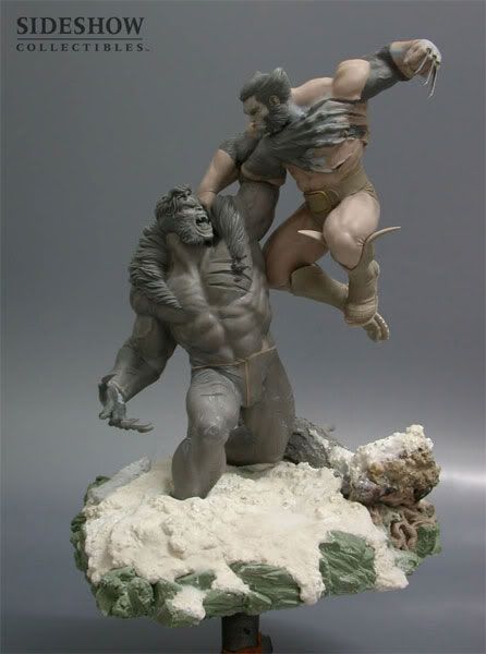

In the next stage, Martin then molded the baked sculpture to create a copy. This is where he really starts the detailing work. Martin displays the muscles in layers, marking the tension points and insertions, then adds the veins (they help immensely to give more strength to the whole) and finally covers everything with a thin layer of epoxy skin that serves to unify the total structure.

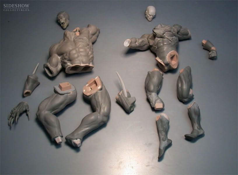

Then comes the process of engineering the breakdown points, which is also the most difficult portion to the production phase. At this moment you have to be like Jack the Ripper since you have to dismantle a complete body with clean, precise cuts, but less blood. When ready, you have to make all the keying components that will allow you to reassemble your sculpture. Once done, Martin matched up all the pieces to make sure everything fits in its proper place.

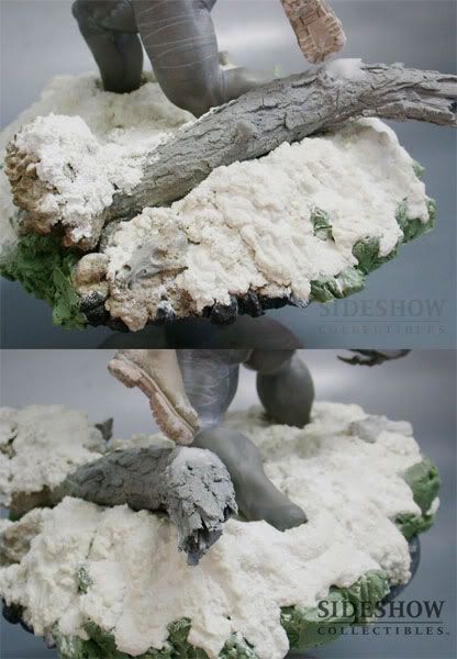

Last, but not least, comes all the intricate detailing such as adding the hair, the specific detail of the costumes and adding the blades to Wolverine's left hand. The display base was made using Castilene for the stones and a mix of Aves Clay shay/paper mache for the snow.

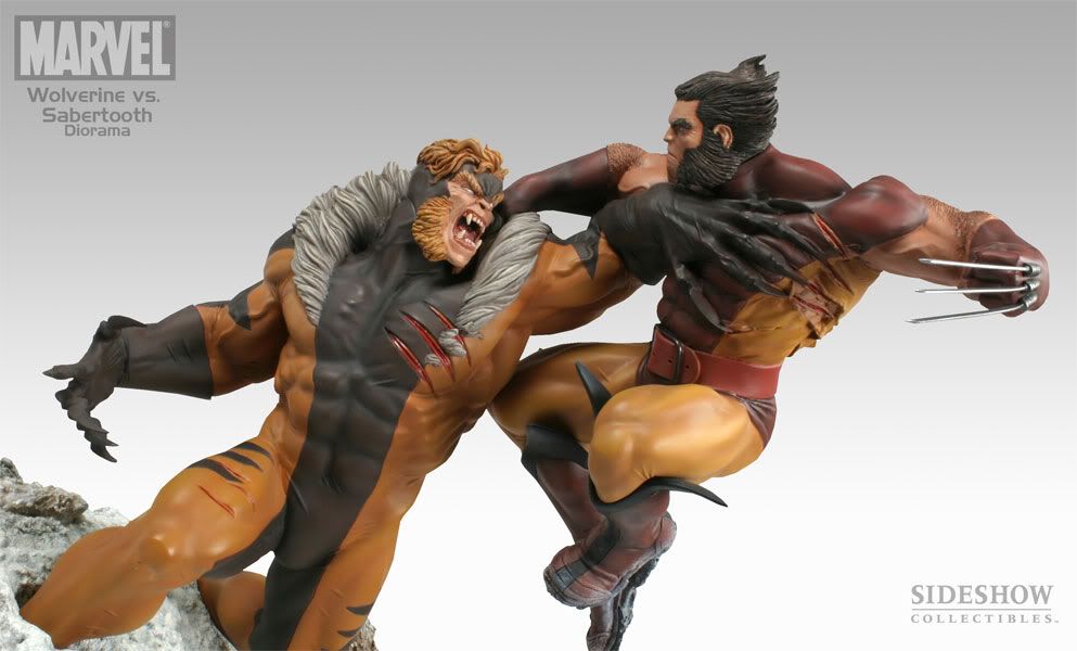

After the sculpture has been completely reassembled and fully detailed, it was shipped off to the Sideshow office for its painting process, completed by the Sideshow creative team.
