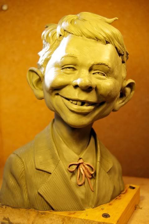

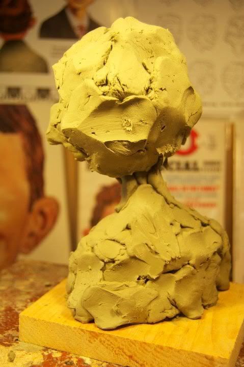

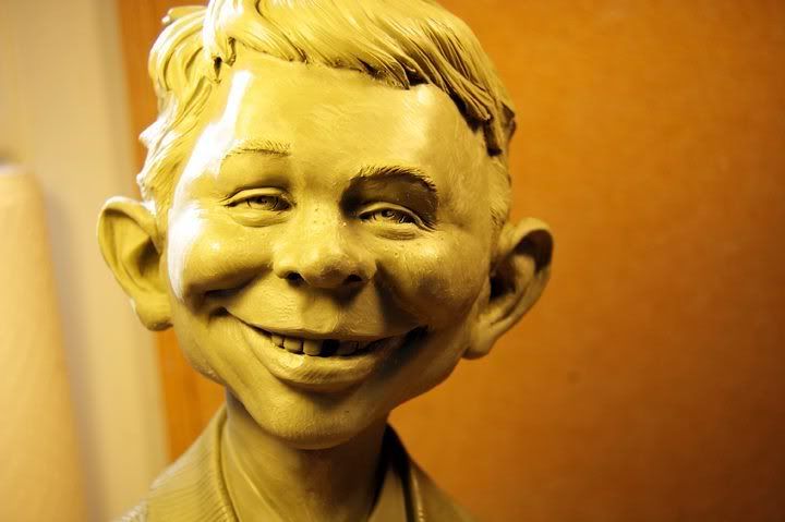

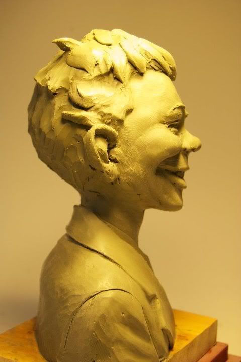

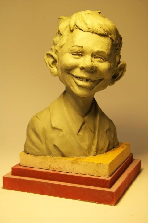

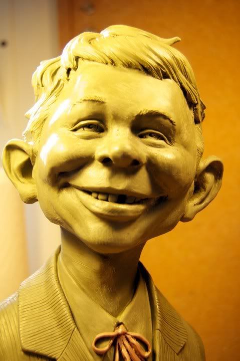

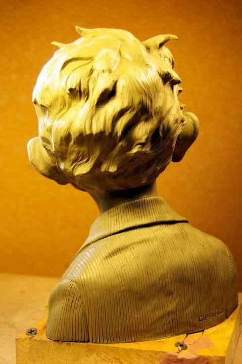

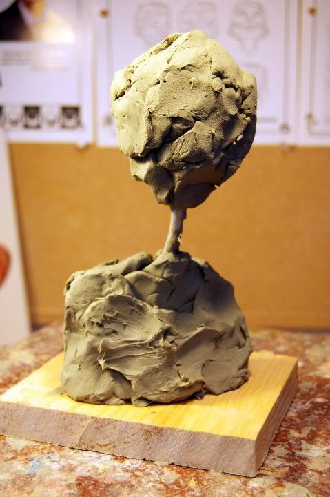

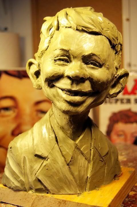

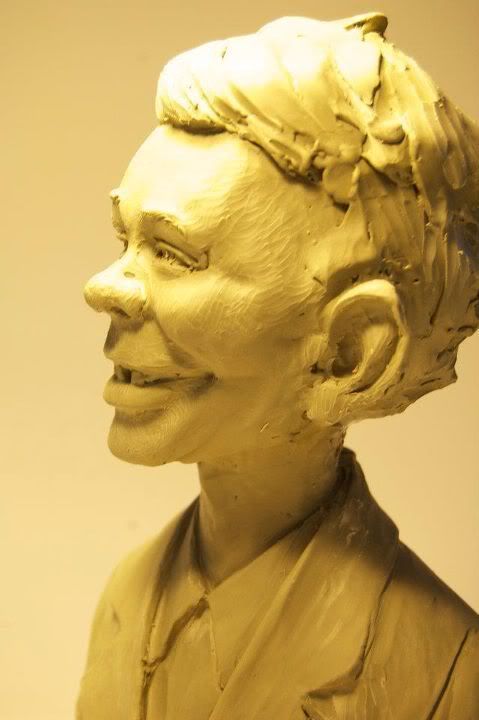

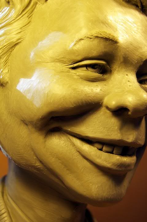

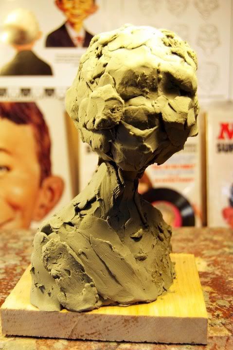

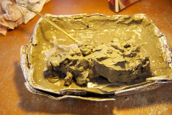

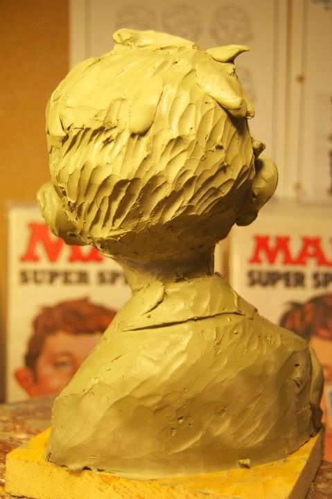

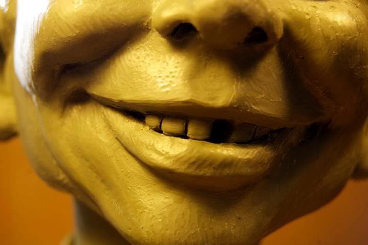

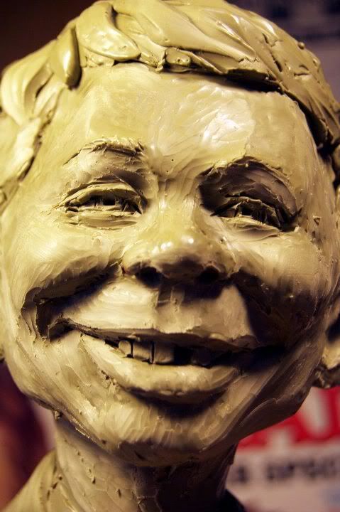

Originally Posted by Tony Cipriano Sculpture

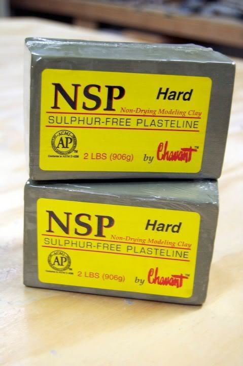

This is the Chavant clay. It doesn't have sulphur in it so it won't impede the silicone when I g to mold the bust.

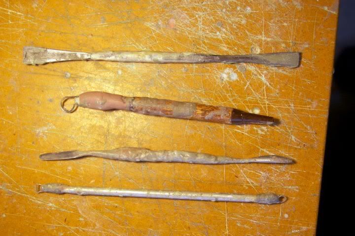

My favorite few tools. EVERYTHING you see in every one of my almbums wer done using these 4 tools & very little else. They do it all. a rake, a spatula, a large loop and a tiny loop. Aaaat's all you really need.
This is the epoxy resin I use to secure my armature. It's two parts, and you mix them equally. In a few hours, it is rock hard. Or you an speed up the process with heat.

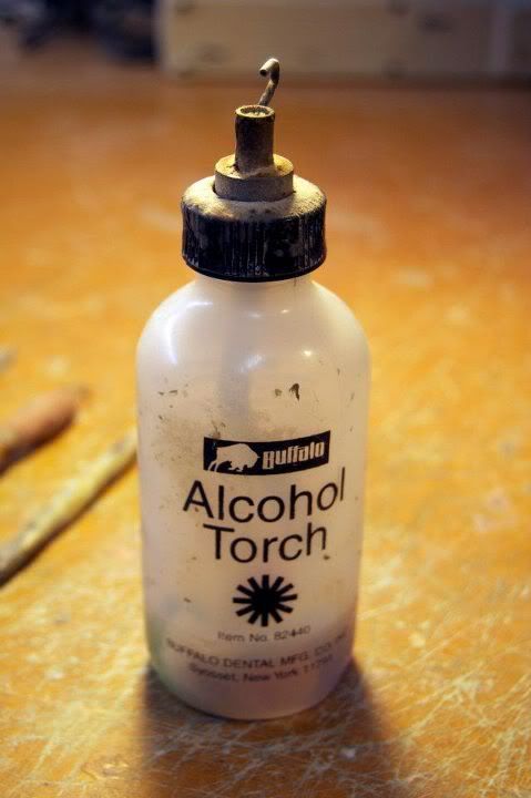

My trusty alcohol torch. Best 5 bucks I ever spent.

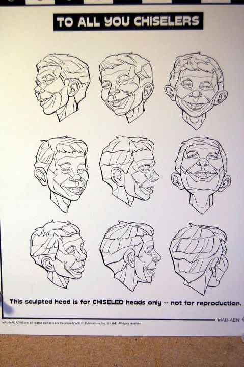

An incredibly useful page form the MAD style guide..specifically used to guide 3D art of Alfred.
I'm pinning up refereence material. The page on the board to the left is a PERFECT 3d statue of Alfred done by my pal, mentor and incredible sculptor, Kent Melton. The MAD issues from the 70's were mine when I was a kid. I rescued them form my mother's attic before the squirrels got them.
Yes...I was a fan boy. The more reference you gather, the easier it makes things.

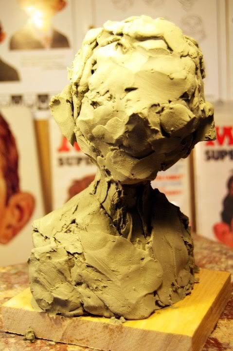

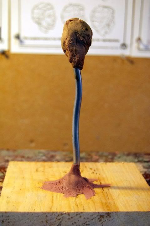

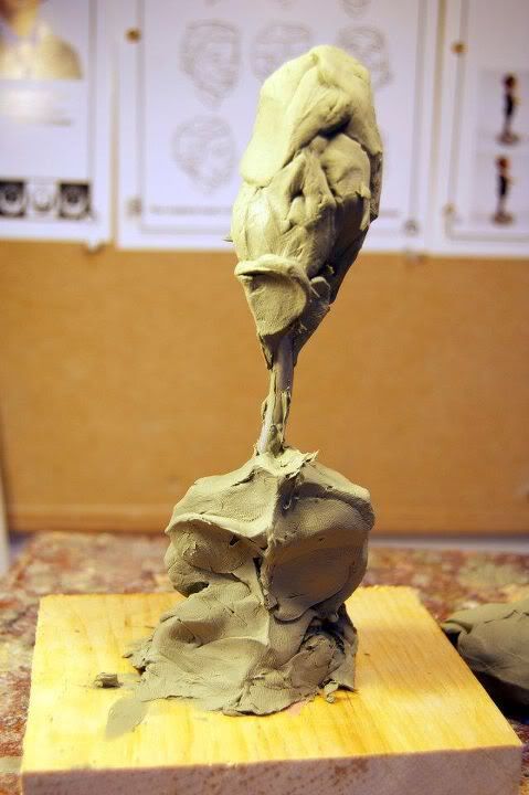

This is the armature. Talk about high tech, huh? It's a lenght of 1/4 inche aluminum wire secured to a baord and a blob of epoxy putty on top. Takes about 2 minutes to make and you are ready for clay!!! ( after epoxt is hard, of course.) With this kind of amrature, as opposed to a pipe, I can pose/tilt the head a little. after I begin to put the clay on.

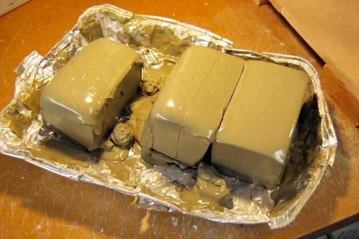

The clay in a baking pan...fresh out of the oven whenre I warmd it up. Believe me, when this clay is cool, it is rock hard.
After I used some.

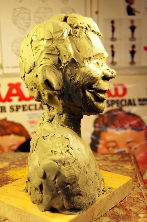

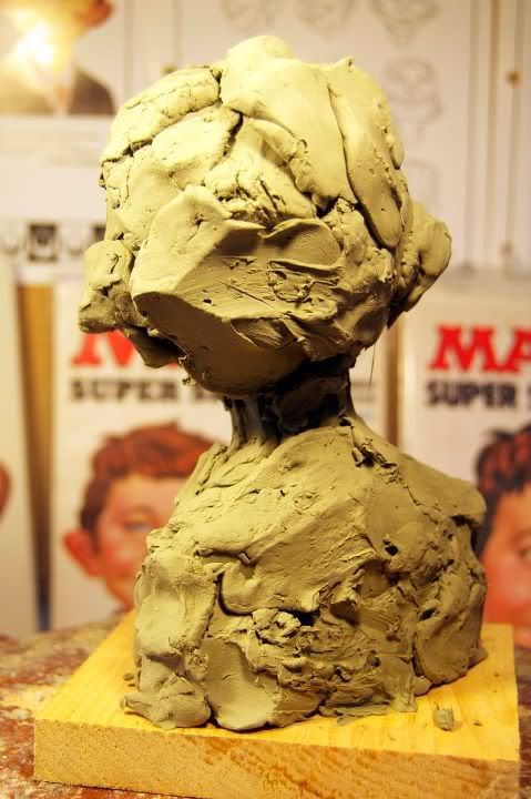

Beginning to squeeze the clay onto the armature.
blocked out skull and shoulders. I can still reposition the head if I want.
a little more...
hints of cheeks

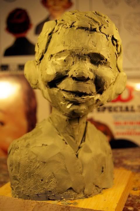

always turning it to build up back at the same time as the front...
no tools yet. Still jut thumbs.

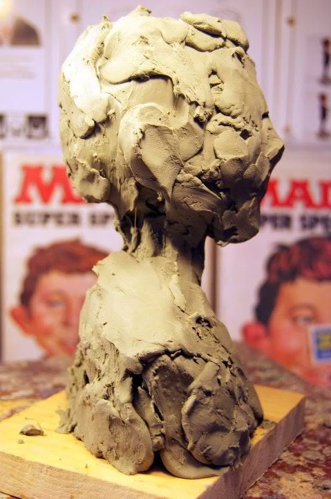

working fast to get the forms down...
not worried about any detail yet.

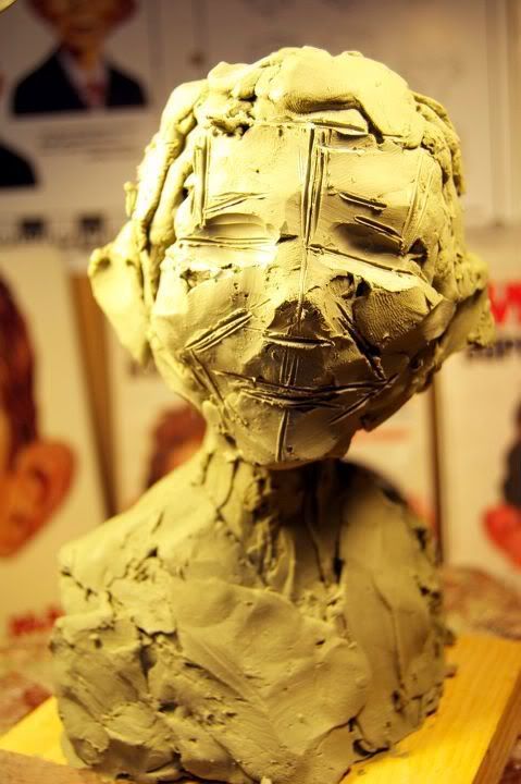

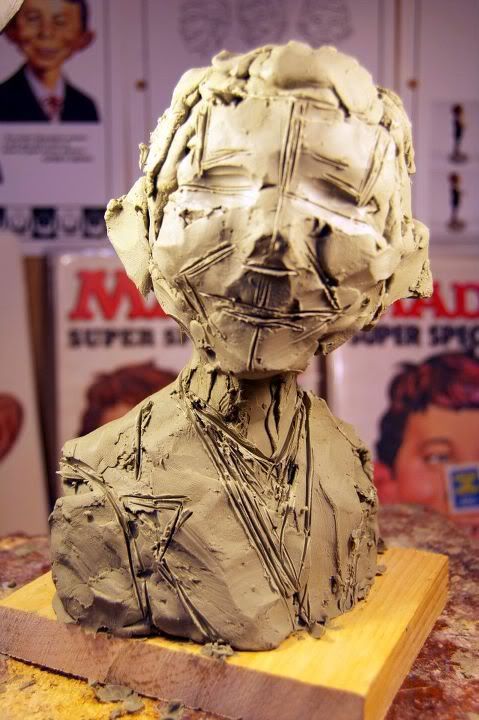

I take a pointy tool and scribe in lines to guide me. Head has a slight tilt to the viewer right and I twisted the neck to look to his right
scribing more lines to easily see where details and PLANES belong

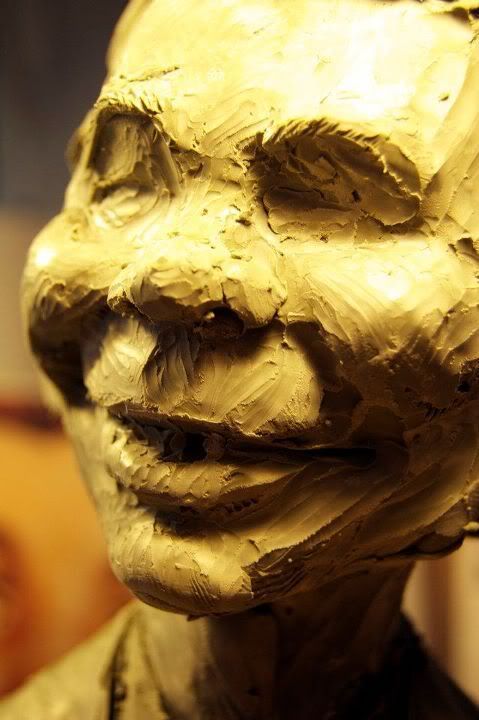

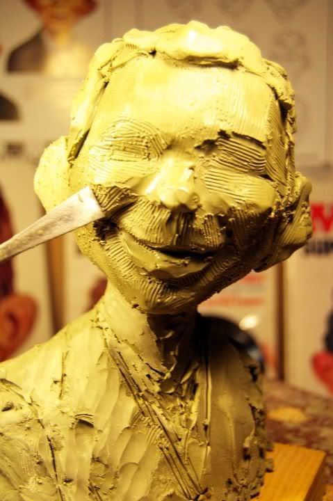

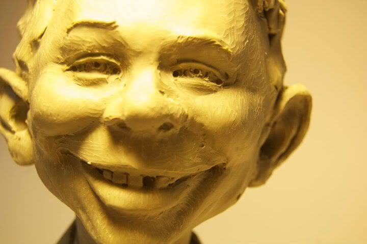

Using rake to blend clay and to define planes of head.
scooped out sockets, begin to add hair..more raking
slightly further..
constantly turning bust and stepping back away from table.
scraping with loops...

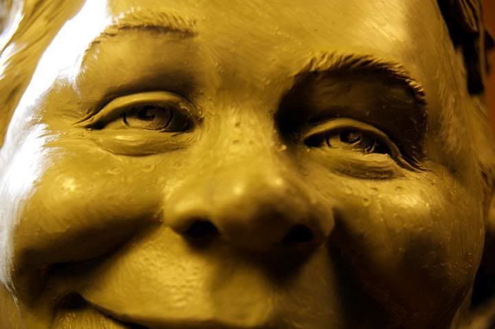

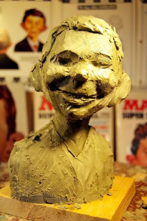

all thep ertinent info is in. Now it's noodle time.

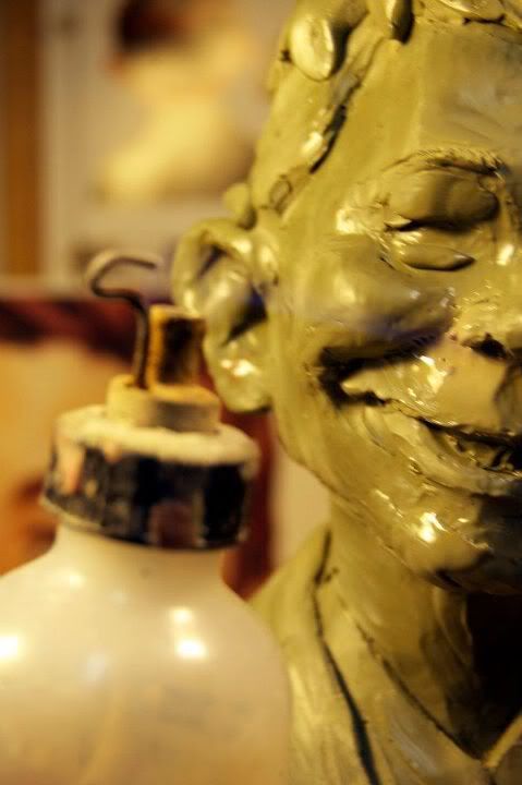

THe bust has ooled so I need to give it a few puffs with the torch to warm up surface. This facilitates the tool work and also smoothes out areas so you can see the surface better
What...me worry?

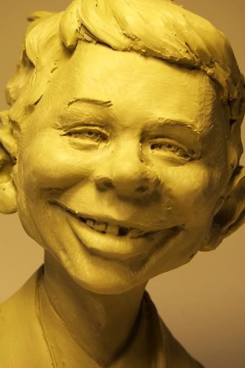

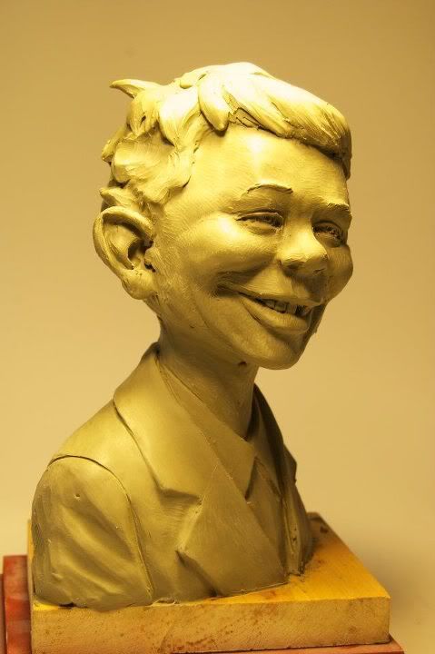

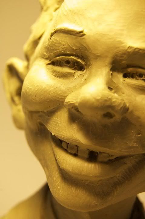

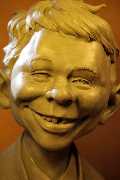

beginning to detail hair. See the planes?
Needs work, but it's all downhill from here. Just detail work.
By Tony Cipriano Sculpture
